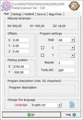

TriaPost7500 Postprocessor for Alphacam v1.00.msi >>> https://bit.ly/3mN7BAZ
V1.00
- poprawione dzielenie dużych programów na części

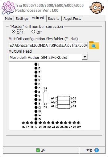

- dodano korekcje zapisu kolejności wierteł (numerów narzędzi) głowic MultiDrill
- dodano obsługę wszystkich formatów plików konfiguracyjnych głowic MultiDrill *.dat (UK) , *.add (ACAM) , *.mdb(USA)
- dodane dwa modele agregatów 3D MultiDrill
- dodane przykładowe konfiguracje głowic MultiDrill w formacie *.dat (UK)
- dodane przykładowe konfiguracje głowic MultiDrill w formacie *.add (ACAM)
- dodana szybka edycja pliku językowego
- dodany plik pomocy
- naprawiony błąd : niezapisywania plików z nazwą dłuższą niż 8 znaków

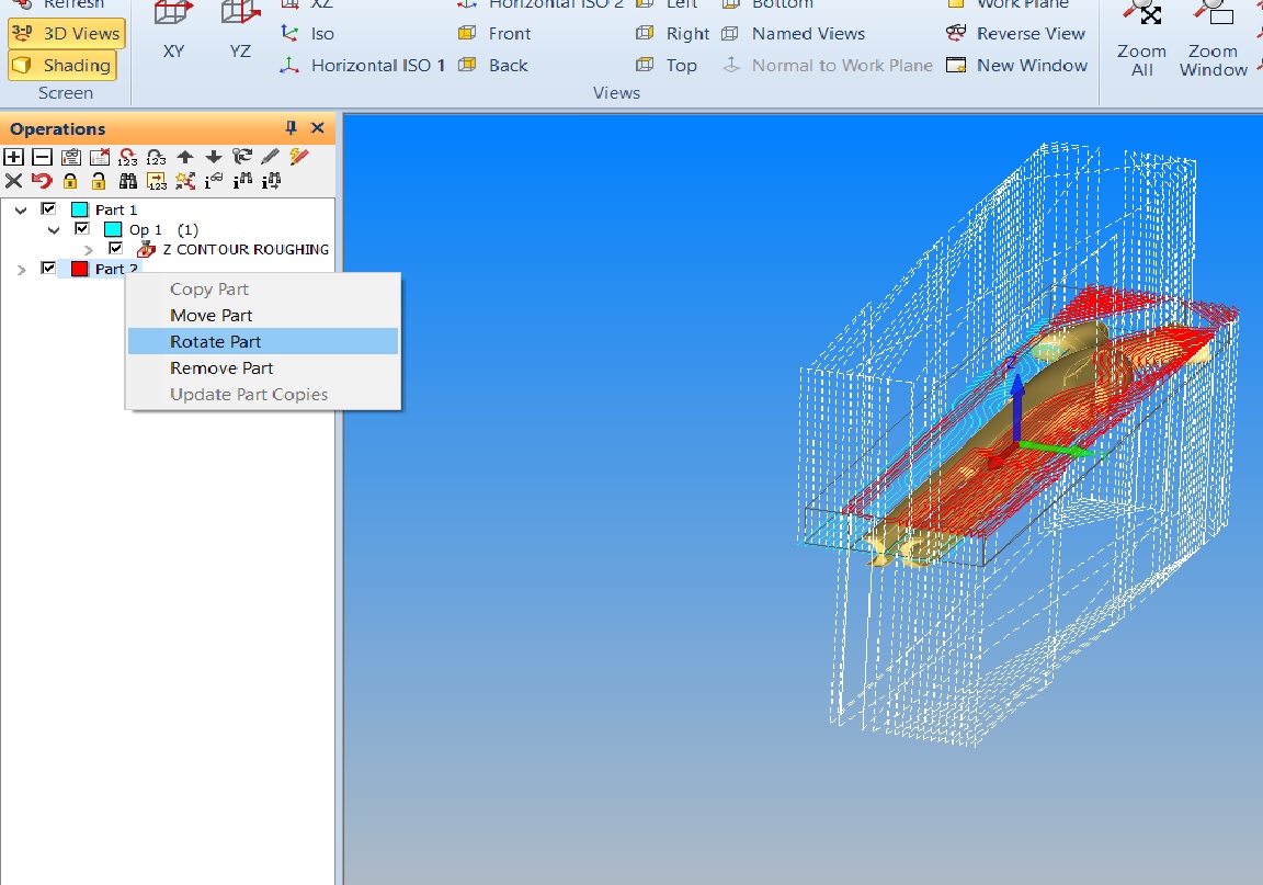

I Have one question. What can i do, if i want to use 4th AXIS. I dont have 4th AXIS. But i will make a "devider". I want to make a Wooden piece of an "hunting gun". I want that 1/4 Side is made, that the machine will NOP(move away from the part) and than wait(like you would press "HOLD BUTTON". Than i turn my part manualy for 90°. I press "RESET HOLD" (or maybe start) and the SIDE 2/4 will be made. And then again NOP, turn the part on side 3/4, "RESET HOLD. And then on the SIDE 4/4.
Divide the program into four parts for each machining side. In Tria, create a list of programs to be executed
part1 - side 0
part2 - side 90
part3 - side 180
part4 - side 270
The postprocessor will split the program at the point where the STOP command was inserted into the Alphacam operations list.

It is the problem that post allows you SPLIT a program with STOP or every ...LINES. Why is not allowed to split it on STOP and every ...lines? But that is not a problem, i can split it manualy in many programs, it is just a proposal.
I have problems with Alphacam. I have learned a basic Alphacam, but not 4-axis.
In the picure below is my print-screen how i make a copy of a part and then rotate of a part. Is this the right way? Becuse when i rotate it makes also the rotate in simulation, but as you can see the toolpath is from the button side on the rotatet part. Witch makes no sense. And when i copy the part, he also copy the material, or Work volume. With one work volume, will not work? The rotated part should have new work volume?
Obrazek [/img]

Upload this Alphacam file, and the 3d model file.

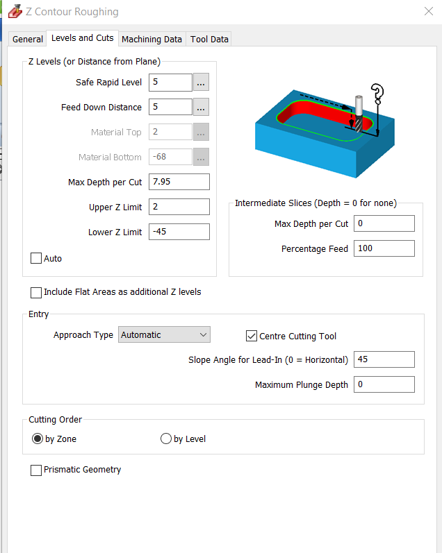

I have 3 questions:
1. I have a problem in Alphacam, that i get null segment error. Because G0 two times in a row:
G0 X=71.39 Y=81.47 Z=37.41 V2 S16 T106
G0 X=71.39 Y=81.47 Z=38.41 V2 S16 T106
It is just 1mm difference in Z. I was thinking problem ist "safe rapid level" and "feed Down distance" . But they are the same. Picture below?

1. I have a problem in Alphacam, that i get segment error. Because G0 two times in a row:
1. To prawdopodobnie postprocesor błędnie zapisuje dwie linie G0. Prześlij ten plik Alphacam w którym ten błąd występuje, na forum lub na email - [email protected] . Wtedy będę mógł sprawdzić jakim momencie generowanie obróbki występuje ten błąd. Postaram się to poprawić i wrzucę na forum poprawiony postprocesor.

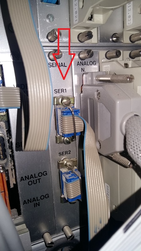

2. U mnie takie problemy występowały gdy podczas przesyłania przez port RS-323 było dużo błędów, i powtórzeń przesyłanych pakietów. Pliki się kopiowały, ale po skopiowaniu pojawiały się losowe wartości jak w twoim przypadku, lub brakowało części pliku. Jednocześnie kopiowanie odbywało się bardzo powoli.
Author 503STC (1994) (tria7500 2.xx) mam wyposażoną w dodatkowy dysk twardy (HDD 40mb). Przy przesyłaniu przez RS-232 bezpośrednio na HDD jest dużo błędów i plik przesyłają się bardzo powoli. Rozwiązaniem było przesyłanie plików nie na HDD, ale bezpośrednio na RAMDISK. Pliki przesyłają się dużo szybciej i bez błędów.
Na drugiej obrabiarce Autor 504 (1999) (Tria7500 3.xx) transmisja tych samych plików jest szybsza niż na A503(tria 2.xx).

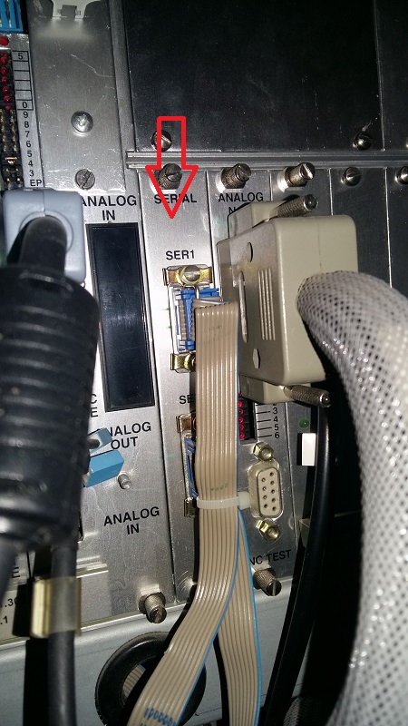

Problemy podczas przesyłania plików może powodować przewód, który wyprowadza gniazdo złącz RS-232 na obudowę. Spróbuj odłączyć go i podłączyć się bezpośrednio do portu rs-232 na sterowaniu (PLC) (ser1)
A503
A504

1. I have send you on e-mail, my program. I have checked, but my postprocessor is in last version 1.0. I have made tests and the Z difference between first G0 and second G0 ist every time just 1mm.

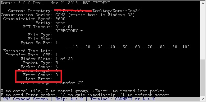

If you are using Dos-Box to emulate MS-kermit, transmitting over RS-232 will cause errors as Dos-box only supports the protocol in 5N1, you need 8N1. Transmission errors will occur. For Windows 7/8/10, it's best to use Kermit for Windows (it's in one of the TriaRS232 add-on folders). Or run MS-Kermit on WindowsXP.

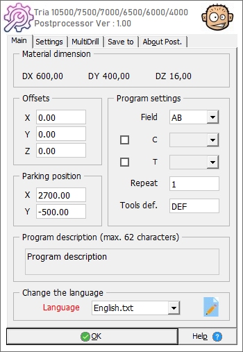

TriaPost7500 Postprocessor for Alphacam v1.02.msi >>> https://bit.ly/37ZEaa8
V1.02
- naprawiony błąd: zapisywania podwójnej linii G0 w programie NC
- wymiar materiału jest od razu widoczny w oknie postprocesora przy pierwszym uruchomieniu
- jeżeli wartości (Offset X, Y, Z) są poza zakresem, pole zostanie podświetlone
- poprawiono zapis do pliku NC
- naprawiony błąd: wyświetlanie nieprawidłowego komunikatu błędu, podczas zapisywania pliku NC z podziałem na części lub wielu arkuszy nestingu
