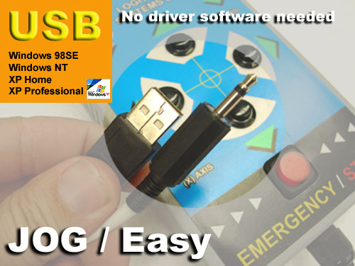

Post napisał: Piotrjub » 02 lis 2005, 21:40
Jog Remote (Ver.2) NEW!!!
(Premium) Postioning Controller
Works with MACH 2 and 3 or similar popular CNC Software
No driver needed works with WIN98 NT or XP
Includes 4 metres of lead .
Premium USB jog remote pendant with EMEG / STOP command
Will position 4 axis,s (X Y Z and A axis)
ON THE FLY Cutting and JOG speed capability with Program / Pause feature
More Info.........
A wiec mozna bez problemu podlaczyc
