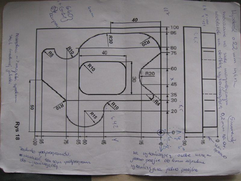

KONFIGURACJA
{ OBRABIARKA MTS VMC-024_ISO30_-0500-0400x0450
{ STEROWANIE SINUMERIK 840DM
{ WYMIARY SURÓWKI X+100.000 Y+100.000 Z+052.000
{ POZYCJA PRZ. OBR. X+197.000 Y+148.000
{{ Lewe przednie górne naroże przedm. obrab.: X+197.000 Y+148.000 Z+052.000
{ MATERIAŁ "P\Stal automatowa\35S20"
{ MOCOWANIE NA PŁYCIE MAGN.
{ AKTUALNE NARZĘDZIE T01
{ NARZĘDZIA
{ T01 "ISO SK 30\Frez walcowo czołowy\MW-040 032 HSS ISO 2586"
{ T02 "ISO SK 30\Frez palcowy\ME-18.0 032K HSS ISO 1641"
{ T03 "ISO SK 30\Frez palcowy do obr. wyk.\ME-18.0 032K HSS ISO 1641"
{ T04 "ISO SK 30\Frez palcowy do rowków\MS-18.0 032K HSS ISO 1641"
{ T05 "ISO SK 30\frez palc. do rowków do obr. wyk.\MS-18.0 032K HSS ISO 1641"
{ WARTOŚCI KOREKCJI
{ D01 T01 R020.000 Z+115.500 N01
{ D02 T02 R009.200 Z+107.000 N01
{ D03 T03 R009.200 Z+107.000 N01
{ D04 T04 R009.000 Z+107.000 N01
{ D05 T05 R009.000 Z+107.000 N01
{ PKTY ZEROWE PRZEDM.
{ G54 X+297.000 Y+248.000 Z+050.000
N180 G0 X-100 Y-121 Z10
N185 GO X30 Y30 ;PUNKT WYMIANY NARZĘDZIA
N190 T2 D1 M6
N195 S1800 F200 M3 M8
N200 G0 X-21 Y10 Z1
N205 L5 P4 ; KONTUR ZEWNĘTRZNY - OBRÓBKA ZGRUBNA
PROGRAM L5 :
N210 G1 G91 Z-4
N215 G90
N220 G1 G41 X-30 Y-15
N225 G1 Y-45 RND=10
N230 G1 X-20
N235 G3 I0 J-10 AR-180 (LUB X-20 Y-75 CR=15)
N240 G1 X-30 RND=10
N245 G1 X-50 Y-95
N250 G1 X-80 RND=8
N255 Y-85
N260 G3 I0 J10 AR=180 (LUB G3 X-80 Y-95 CR=10)
N265 G3 X-95 Y-40 CR=30
N270 G1 X-95 Y-20
N275 G3 X-75 Y0 CR=20
N280 G1 X-60 Y-15
N285 G1 X-30 Y0 RND=4
N290 G1 X-30 Y-15
N295 G0 G40 X-21 Y10
N300 M17
N305 G0 X30 Y30 Z10
N310 T3 D1 M6
N315 S1800 F200 M3 M8
N320 G0 Z1
N325 X-55 Y-35
N330 L6 P4 ; KIESZONKA - OBRÓBKA ZGRUBNA
PROGRAM L6 :
N335 G1 G91 Z-4
N340 G90
N345 G41 G247 X-65 Y-45 DIRS=10
N350 G1 Y-65 RND=10
N355 G1 X-50
N360 G1 X-35 RND=10
N365 G1 X-45
N370 G1 Y-25 RND=10
N375 G1 X-50
N380 G1 X-65 RND=10
N385 G1 Y-45
N390 G40 G248 X-55 Y-55 DIRS=10
N395 G0 X-55 Y-35
N380 M17
N385 G0 Z1
N390 G0 X30 Y30
N395 T4 D1 M6
N400 S1800 F200 M3 M6
N405 G0 X-21 Y10 Z-11
N410 L5 P1 ; OBRÓBKA WYKAŃCZAJĄCA KONTURU ZEWNĘTRZNEGO
N415 G0 Z1
N420 G0 Z30 Y30
N425 T5 D1 M6
N430 S1800 F200 M3 M8
N435 G0 Z1
N440 G0 X-55 Y-35
N445 G0 Z11
N450 L6 P1; OBRÓBKA WYKAŃCZAJĄCA ŚCIANEK KIESZENI
N455 G0 Z1
N460 T0 D0 G0 X30 Y30 M9 M5 M30
