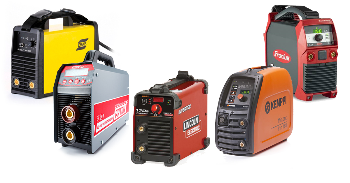

- Spawarka ESAB BUDDY ARC 180
- Spawarka PATON VDI 200P
- Spawarka LINCOLN Invertec 170S
- Spawarka FRONIUS TransPocket 150
- Spawarka KEMPPI Minarc Evo 180

| Paton | Fronius | Lincoln | Esab | Kemppi |
| 4 | 3 | 3 | 5 | 2 |
| 5 | 2 | 3 | 4 | 4 |
| 5 | 4 | 4 | 4 | 4 |
| 5 | 4 | 3 | 2 | 4 |
| 5 | 4 | 3 | 4 | 5 |
| 5 | 4 | 3 | 3 | 3 |
| 5 | 5 | 4 | 3 | 4 |
| 4,86 | 3,71 | 3,29 | 3,57 | 3,71 |
