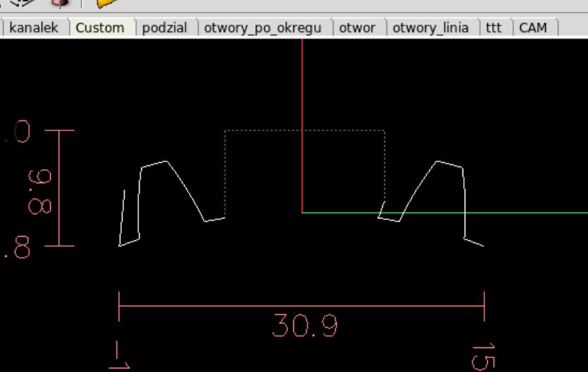

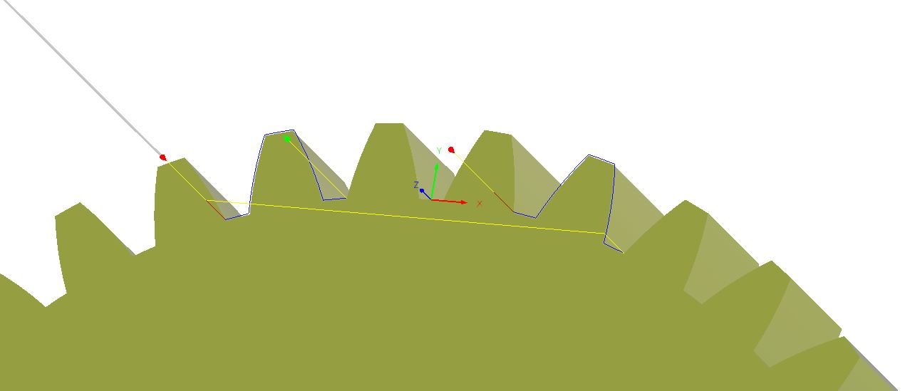

Post napisał: kamar » 26 kwie 2025, 06:30
kamar pisze:
25 kwie 2025, 18:43
Jak przyślesz to Ci zęby natnę wolnym czasem.
A jak masz gdzieś pod ręką drutówkę z obsługą g-kodów to masz gotowe na drut 0.18.
Kod: Zaznacz cały
(1001)
(T1  D=0.18 CR=0.09 - ZMIN=0. - FREZ KULISTY)
N10 G94 G17 G91.1
N15 G21
(KONTUR 2D1)
N20 M9
N25 S5000 M3
N30 M8
g0 x-15
y2
N40 G90 G1 X-15.453 Y-2.809 f2
N45 G0
N55 G1
N65 X-14.895 Y-2.596
N70 X-14.334 Y-2.392
N75 X-13.771 Y-2.195
N80 X-13.813 Y-1.596
N85 X-13.841 Y-0.996
N90 X-13.856 Y-0.395
N95 X-13.858 Y0.206
N100 X-13.847 Y0.807
N105 X-13.823 Y1.407
N110 X-13.785 Y2.007
N115 X-13.734 Y2.606
N120 X-13.671 Y3.204
N125 X-13.594 Y3.8
N130 X-13.583 Y3.832
N135 X-13.56 Y3.858
N140 X-13.53 Y3.873
N145 X-12.853 Y4.065
N150 X-12.174 Y4.247
N155 X-11.492 Y4.419
N160 X-11.458 Y4.421
N165 X-11.426 Y4.41
N170 X-11.4 Y4.387
N175 X-11.035 Y3.91
N180 X-10.681 Y3.424
N185 X-10.338 Y2.931
N190 X-10.005 Y2.43
N195 X-9.684 Y1.922
N200 X-9.374 Y1.408
N205 X-9.075 Y0.886
N210 X-8.788 Y0.358
N215 X-8.513 Y-0.176
N220 X-8.249 Y-0.716
N225 X-7.663 Y-0.604
N230 X-7.075 Y-0.501
N235 X-6.486 Y-0.406
N240 G0 y7
(KONTUR 2D1 2)
N250 M8
x7
y1
N255 G1 X6.486 Y-0.406
N270 G1
N280 X7.075 Y-0.501
N285 X7.663 Y-0.604
N290 X8.249 Y-0.716
N295 X8.513 Y-0.176
N300 X8.788 Y0.358
N305 X9.075 Y0.886
N310 X9.374 Y1.408
N315 X9.684 Y1.922
N320 X10.005 Y2.43
N325 X10.338 Y2.931
N330 X10.681 Y3.424
N335 X11.035 Y3.91
N340 X11.4 Y4.387
N345 X11.426 Y4.41
N350 X11.458 Y4.421
N355 X11.492 Y4.419
N360 X12.174 Y4.247
N365 X12.853 Y4.065
N370 X13.53 Y3.873
N375 X13.56 Y3.858
N380 X13.583 Y3.832
N385 X13.594 Y3.8
N390 X13.671 Y3.204
N395 X13.734 Y2.606
N400 X13.785 Y2.007
N405 X13.823 Y1.407
N410 X13.847 Y0.807
N415 X13.858 Y0.206
N420 X13.856 Y-0.395
N425 X13.841 Y-0.996
N430 X13.813 Y-1.596
N435 X13.771 Y-2.195
N440 X14.334 Y-2.392
N445 X14.895 Y-2.596
N450 X15.453 Y-2.809
N650 G0
N660 M9
N665 M30
