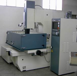

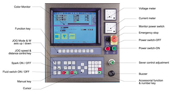

Pod koniec marca do nas przyszła taka nowa maszyna.
Ma takie parametry:
Machinery NC-F304N NCF Model Fluid tank 600 Litrów
Capacity of work tank 1550x880x500 mm
Max. output current 90A
Work table dimension 1000x500 mm
Input electric power 10KVA
Longitudinal travel
( X Axis ) 550 mm
Cross travel
( Y Axis ) 450 mm
Spindle travel &
Headstock travel 300+300 mm
Max. processing speed 600 mm3/min
Electrode wear ratio 0.15%
Best surface finish Ra0.2ľm
Max. distance between electrode holder plate
to table top 740 mm
Max.programming capacity 200x50 blocks
Max. Electrode weight 250 kgw
Min. D.R.O. resolution 0.005 mm
Loading capacity of work table 2000 kgw
Min.D.R.O. resolution 2000.000 mm
Machine weight 3000 kgw
Permant memory device D.O.M
Machine outside DIM
( WxDxH ) 3200x2000x2500 mm

- Załączniki
- Resize of PICT1471a1.jpg (12.72 KiB) Przejrzano 8123 razy
- computer.jpg (36.57 KiB) Przejrzano 8142 razy
