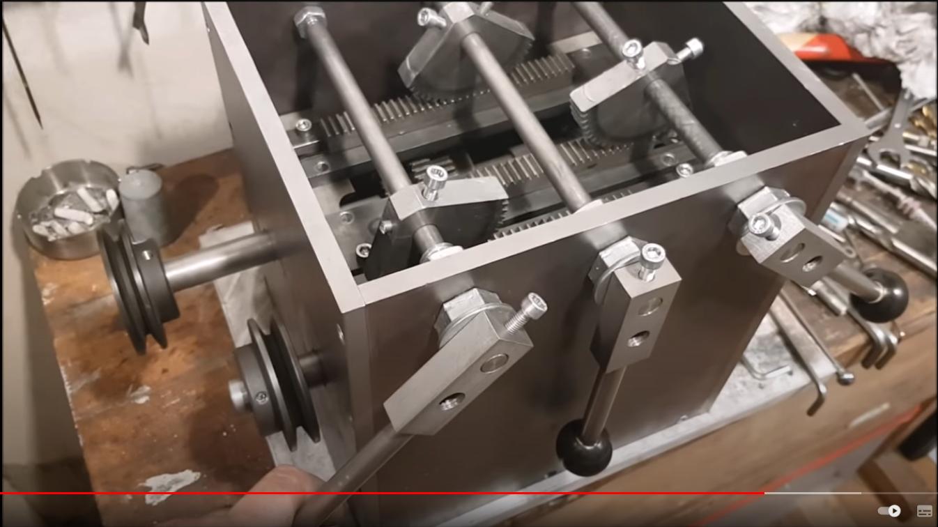

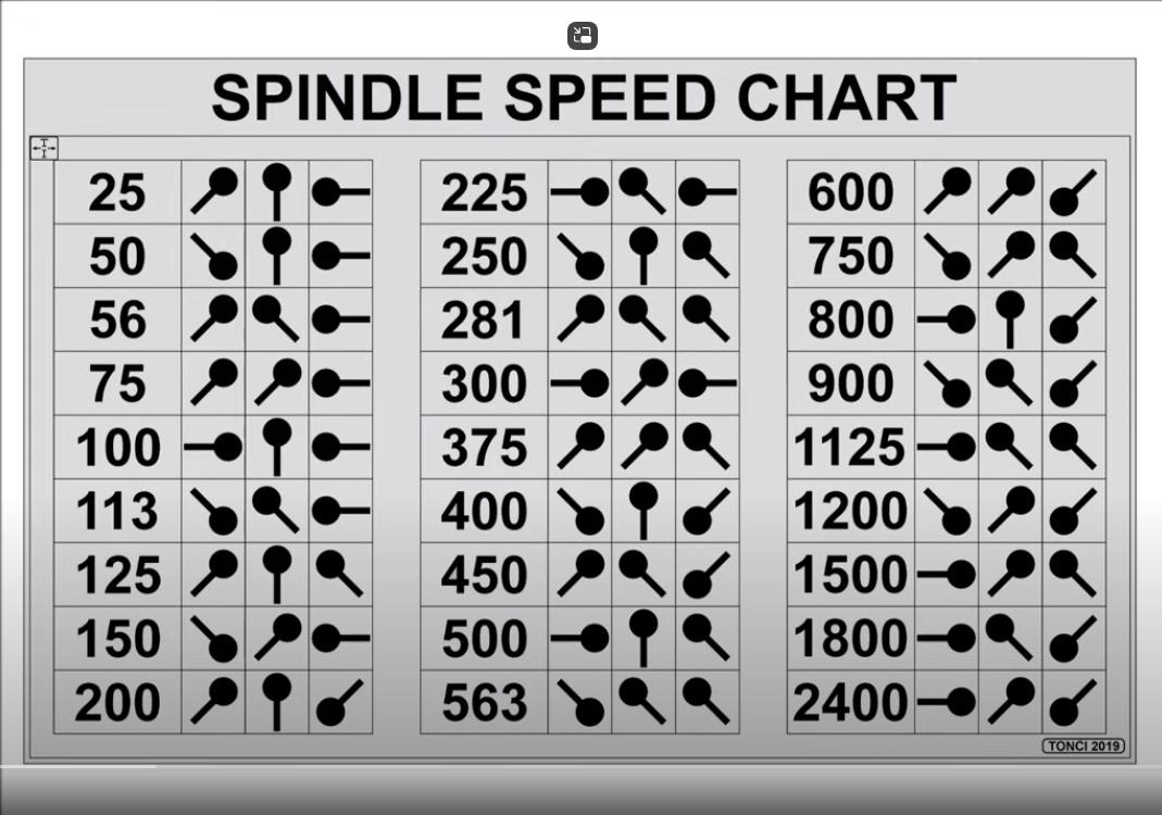

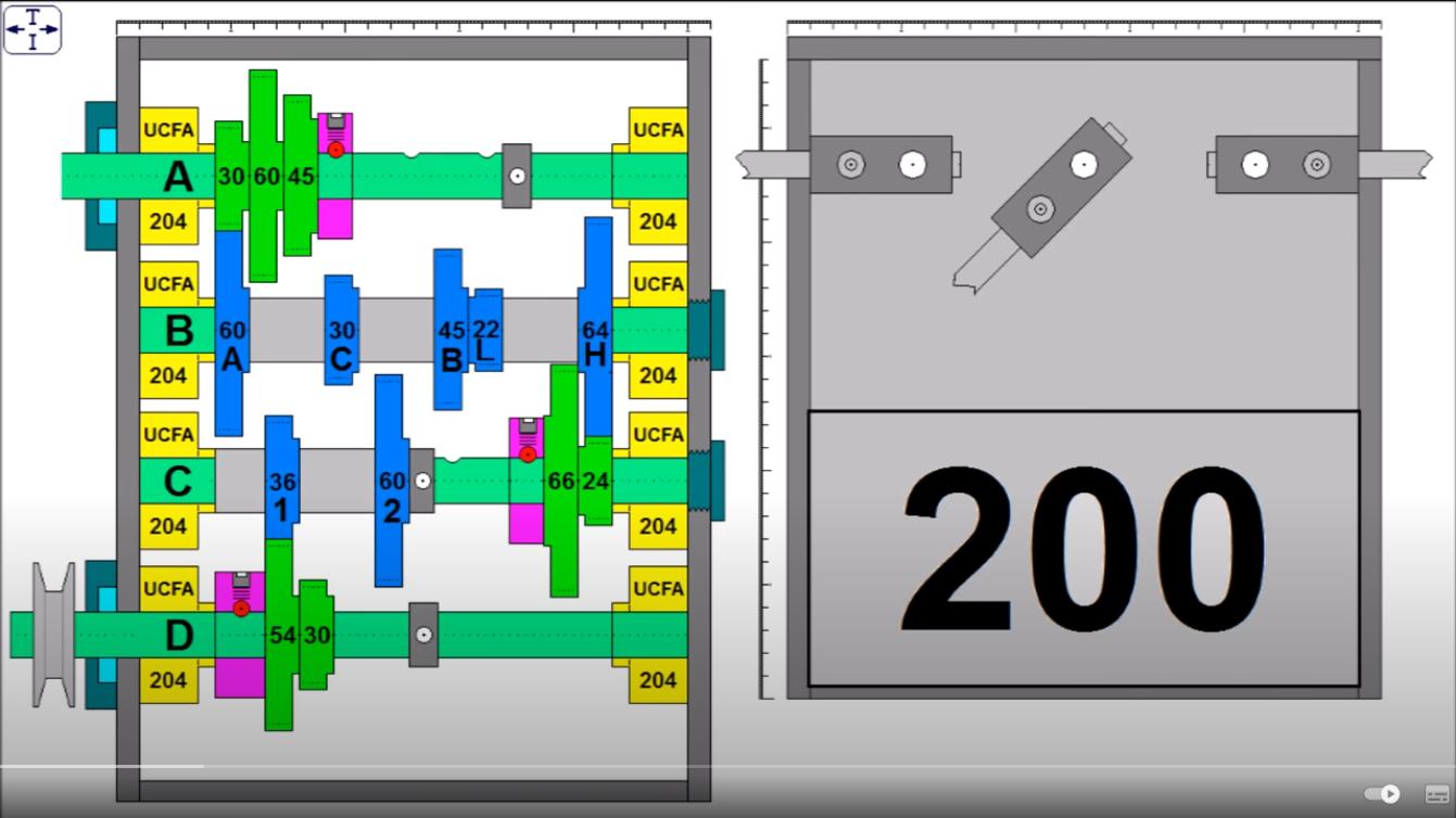

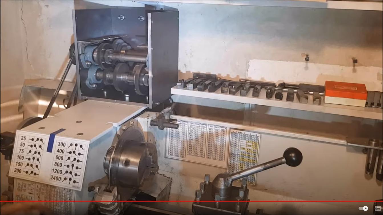

Może to być instrukcja dla tych którzy sami zechcą zbudować przystawkę do posiadanej tokarki bez przekładni.
Forum member LMMasterMariner (builder of 38 homemade tools) built this lathe headstock external gearbox, and then posted an updated version with more speeds and many plans files.
Adding an external gearbox makes a belt-driven lathe act like a geared head lathe, which means you get consistent torque at all speeds.
You also don't have to mess around with belts, pulleys, and a belt tensioner in order to change speeds.
LMMasterMariner did this build for around $100. You might pay a little more, depending on where you source the gear blanks. It's still a huge savings over buying a geared head lathe.
His original build was for a 12-speed gearbox, and the discussion includes a video showing construction and operation.
His second generation build has 27 speeds, and he also included 24 downloadable plans files with it.
Click here to see the first gearbox. https://www.homemadetools.net/forum/hom ... post110997
Click here to see the updated version with plans. https://www.homemadetools.net/forum/27- ... post116203
P.S. If you can't view the above links, you can signup here https://www.homemadetools.net/amember/s ... -ps_signup.

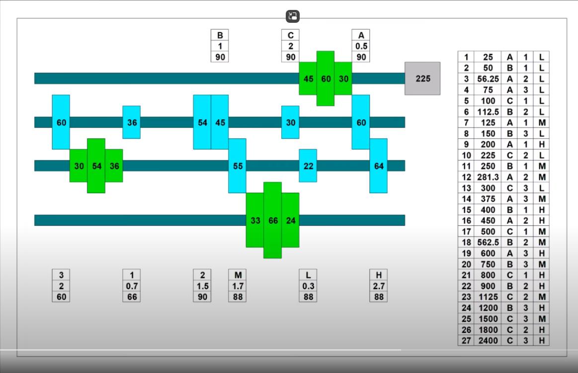

wersja 27 biegów
Obrazek Obrazek
Obrazek Obrazek

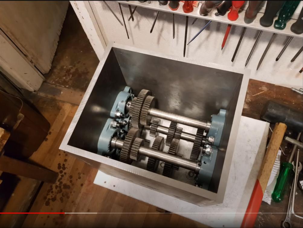

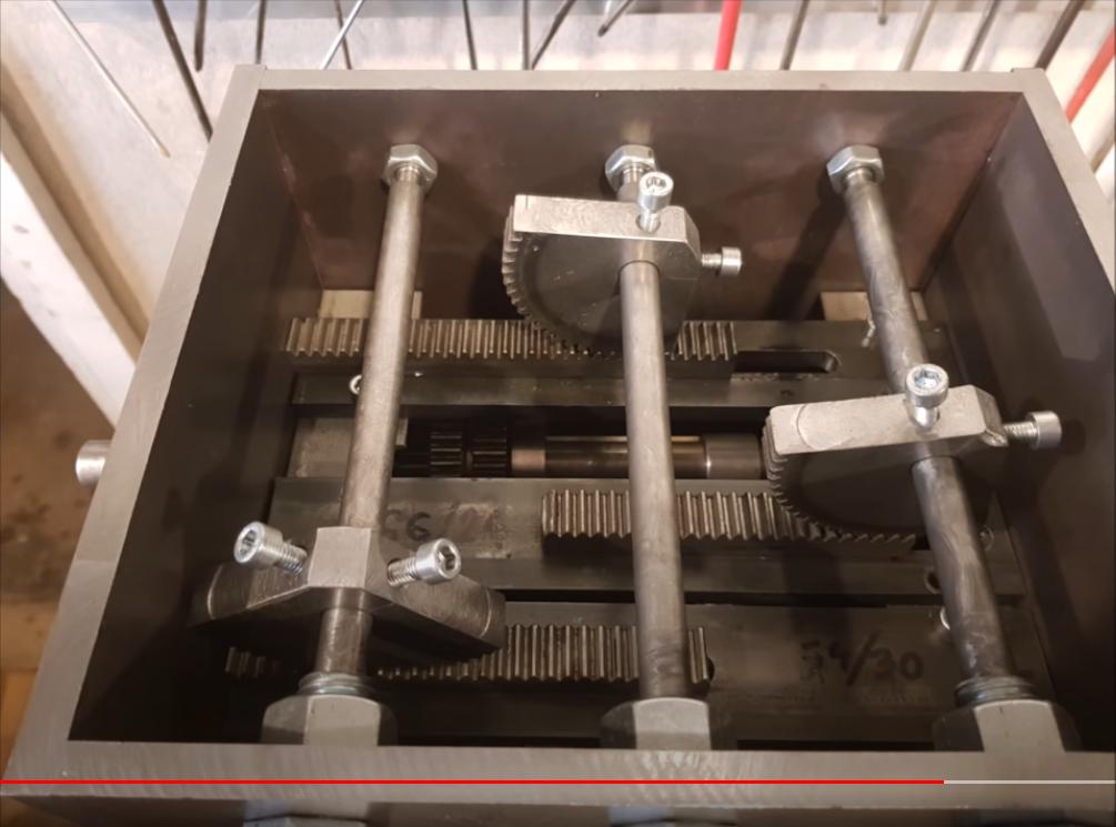

wersja 12 biegów
Obrazek Obrazek
Obrazek Obrazek
Obrazek Obrazek
ObrazekObrazek
Uwaga Korekta;
W A R N I N G /
ONE MISTAKE FOUND.
AND CORRECTED.
CHECK CORRECTIONS.pdf
https://www.homemadetools.net/forum/att ... 1535469667
Korekta do rozstawu osi przekładni.pdf
(179.01 KiB) Pobrany 166 razy
DIDN'T HAVE THIS PROBLEM IN PREVIOUS VERSION (18 SPEEDS) AS THERE WERE 60 TEETH AND 64 TEETH GEARS IN THE SAME LINE
AND WITH COPY / PASTE USED IN DRAWINGS, WELL S...T HAPPENS.

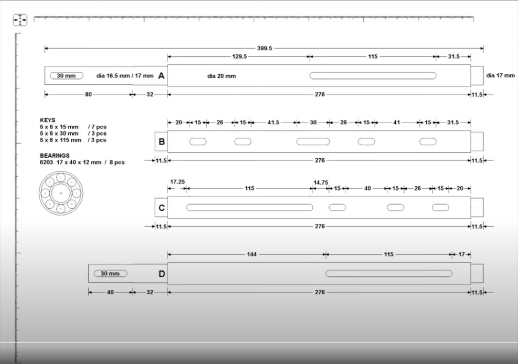

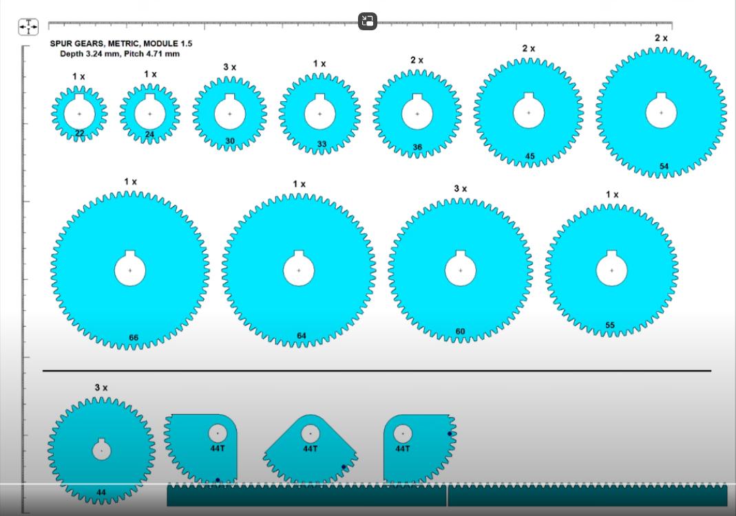

Rysunki wykonawcze części.
Jeśli jest taka możliwość, to poproszę moderatora by dołączył ten spis do postu tytułowego aby ewentualny czytelnik miał wszystko w jednym.
001 cover.pdf (374.4 KB, 839 views) https://www.homemadetools.net/forum/att ... 1535134557
002 GEARBOX.pdf (19.7 KB) https://www.homemadetools.net/forum/att ... 1535134570

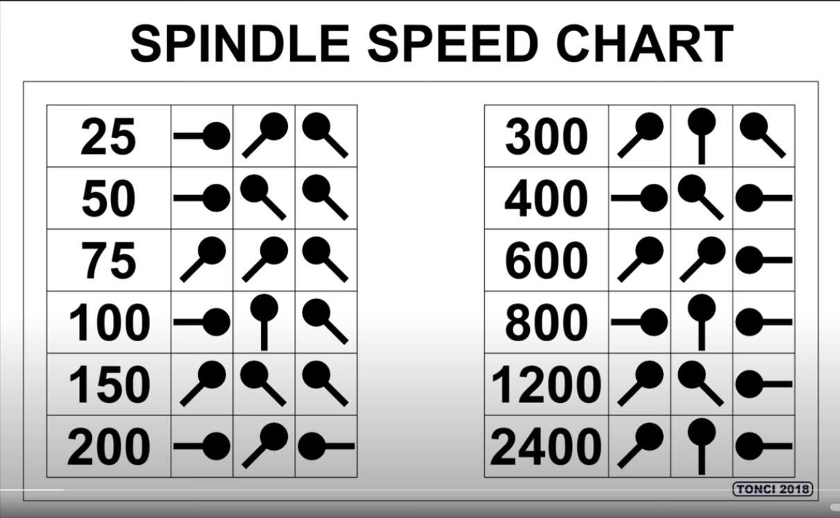

003 spindle speed chart.pdf (687.4 KB, 674 views) https://www.homemadetools.net/forum/att ... 1535134599
004 gears.pdf (49.1 KB, 635 views) https://www.homemadetools.net/forum/att ... 1535134615
005 GEAR CLUSTERS.pdf (43.5 KB, 637 views) https://www.homemadetools.net/forum/att ... 1535134627
006 SCREENSHOT.pdf (46.7 KB, 616 views) https://www.homemadetools.net/forum/att ... 1535134640
007 base plate.pdf (14.9 KB, 607 views) https://www.homemadetools.net/forum/att ... 1535134653
008 PULLEYS SIDE PLATE.pdf (20.5 KB, 649 views) https://www.homemadetools.net/forum/att ... 1535134671
009 CHUCK SIDE PLATE.pdf (20.5 KB, 589 views) https://www.homemadetools.net/forum/att ... 1535134683
010 FRONT PLATE.pdf (17.7 KB, 579 views) https://www.homemadetools.net/forum/att ... 1535134698
011 BACK PLATE.pdf (17.1 KB, 629 views) https://www.homemadetools.net/forum/att ... 1535134710
012 TOP PLATE.pdf (16.6 KB, 585 views) https://www.homemadetools.net/forum/att ... 1535134730
013 shafts.pdf (22.9 KB, 604 views) https://www.homemadetools.net/forum/att ... 1535134744
014 shafts.pdf (20.5 KB, 617 views) https://www.homemadetools.net/forum/att ... 1535134759
016.pdf (25.0 KB, 610 views) https://www.homemadetools.net/forum/att ... 1535134782
017.pdf (26.5 KB, 604 views) https://www.homemadetools.net/forum/att ... 1535134813
018.pdf (30.4 KB, 609 views) https://www.homemadetools.net/forum/att ... 1535134835
019.pdf (25.3 KB, 599 views) https://www.homemadetools.net/forum/att ... 1535134850
020 DIMENSIONS 01.pdf (23.8 KB, 631 views) https://www.homemadetools.net/forum/att ... 1535134871
021.pdf (21.0 KB, 596 views) https://www.homemadetools.net/forum/att ... 1535134886
022.pdf (624.0 KB, 627 views) https://www.homemadetools.net/forum/att ... 1535134914
023.pdf (647.3 KB, 588 views) https://www.homemadetools.net/forum/att ... 1535134948 poprawka https://www.homemadetools.net/forum/att ... 1535444945
024.pdf (24.4 KB, 590 views) https://www.homemadetools.net/forum/att ... 1535134964
025.pdf (20.6 KB, 637 views) https://www.homemadetools.net/forum/att ... 1535134978
