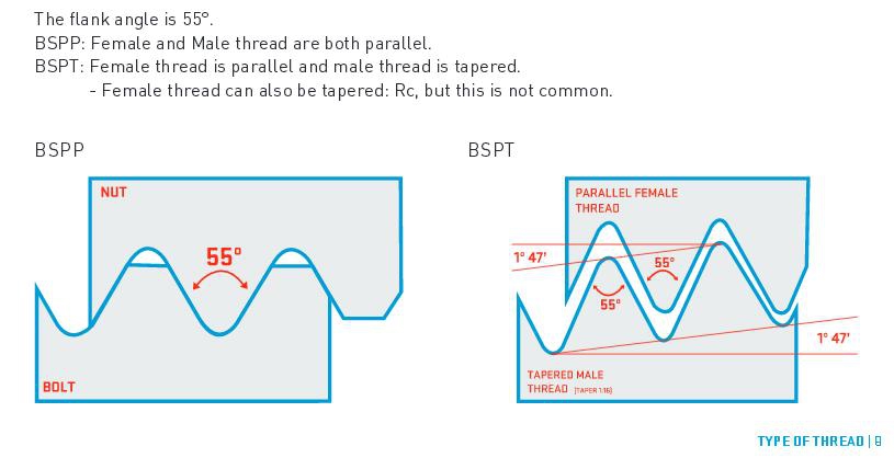

i wrzutka z poradnika mechanika w wersji ogólnoświatowej:
Posty: 12394
Post napisał: RomanJ4 » 02 cze 2016, 12:35
https://www.teesing.com/files/en/brochu ... thread.pdf
G/R/RP - WHITWORTH THREAD (BSPP/BSPT)
G = BSPP ISO 228 (DIN 259)
R/Rp/Rc = BSPT ISO 7 (DIN 2999 replaced by EN10226)
The most common types of whitworth thread are:
BSPP (G) – British Standard Pipe Parallel
BSPT (R/Rp) – British Standard Tapered Pipe, for pipes and tapered thread.
An appropriate sealing compound can be used in the thread to ensure a leak-proof joint.
Czyli krótko mówiąc:
BSPP(G) - jest cylindryczny 55°,
a
BSPT (R/Rp) - jest stożkowy 55°/1°47'
