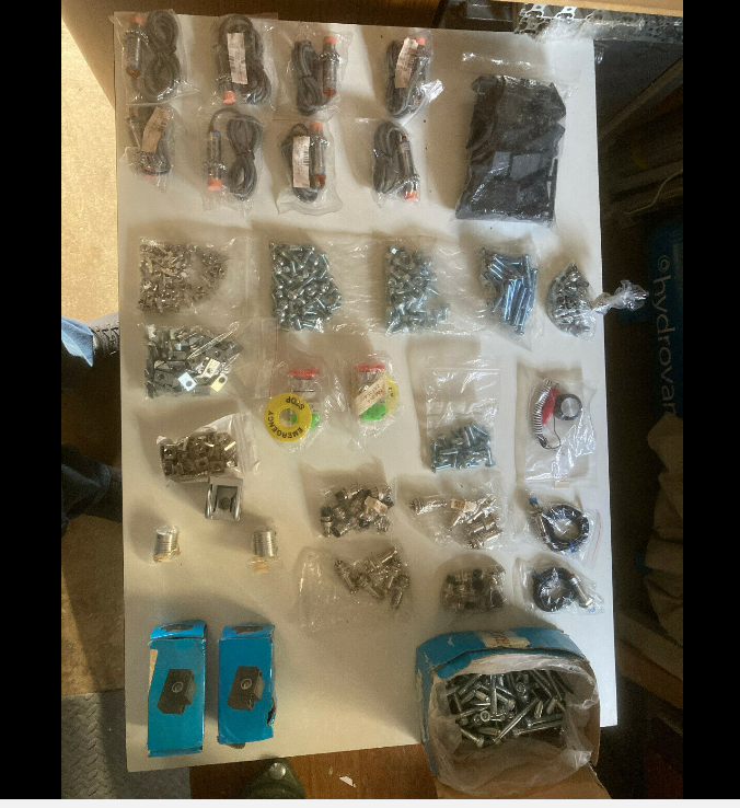

czy warto w to zainwestować jeśli w przyszłości zamierzam zbudować CNC i ile mozna za to dac max?
Aukcja konczy sie za 2h
These are items purchased and stockpiled as part of an recently abandoned CNC build. There is a massive amount of parts here, originally acquired to build a heavy duty cartesian style router, but could easily be adapted to other CNC forms and other end uses such as a plasma cutter, laser or whatever you want.

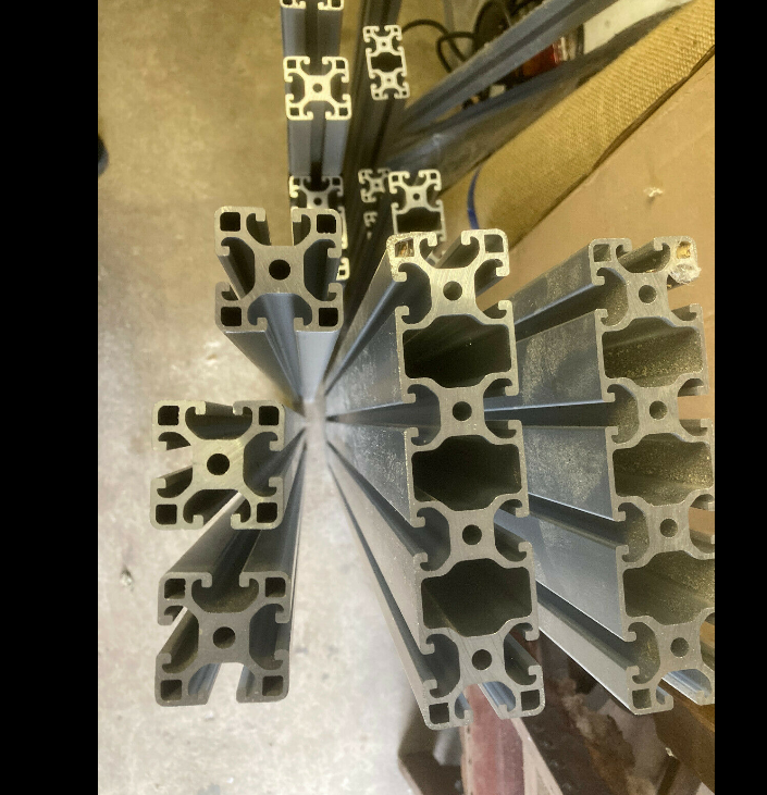

The is also a considerable amount of Slot 8, N x 40mm sections most are new and unused, some still wrapped. This is very high quality section believed to be German (Bosch?) manufactured. A list of the sections follows:-
160mm x 40mm, 1000mm long x 2
80mm x 40mm, 700mm long x 2
80mm x 40mm, 500mm long x 2
40mm x 40mm, 1000mm long x 6
40mm x 40mm, 800mm long x 2
40mm x 40mm, 600mm long x 2
40mm x 40mm, 400mm long x 2
40mm x 40mm, 370mm long x 4
40mm x 40mm, 360mm long x 2
40mm x 40mm, 280mm long x 2
40mm x 40mm, 200mm long x 3
Also included are a large amount of heavy duty 90 degree section connectors and 4 adjustable section connectors, plus a bag full of section end caps.

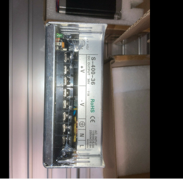

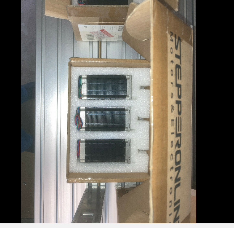

There are 4 brand new (boxed) 23HS45-4204S Nema 23 bipolar-stepper motors. These are 4 wire, 3Nm (425oz) top quality items, complete with a matched power supply system, all purchased from StepperOnline. These alone are £200 in UK, IF you can get hold of them.
There are 6 x Hall effect adjustable safety stop switches, 2 x 400mm Linear Bearing assemblies (possibly for the Z axis), 2 x pairs of Plummer block bearings, 2 x Emergency Stop Switches, 1 x Tool Setting device, 1 x 1000mm Expandable Drag Chain, Bags of aircraft style wiring male & female wiring connectors, drive rod connectors and loads of hardware, mostly 8mm hex cap screws of various length.

Wszystko zalezy od ceny. Brakuje srub kulowych, wrzeciona i sterowania. Profile item wersja ciezka pewnie ponad 100zl za metr jakbys mial kupowac. Silbiki wycenil po 50£ a na alle kupisz po 130zl. Wez kalkulator i policz poprostu co masz na zdjeciach. Zalezy tez co za maszyne chcesz kiedys zlozyc bo albo skladasz z tego co masz i zobaczymy co wyjdzie, albo masz jakies oczekiwania i na ich podstawie dobierasz material i konstrukcje.. Poza tym nie napisales ile ktos za to woła wiec kto ma ci napisac czy sie oplaca to brac..

skmskm
Posty: 332
Rejestracja: 15 lis 2014, 20:21
Lokalizacja: Gliwice
Re: Pilne
Post napisał: skmskm » 05 lis 2021, 13:49
Podliczmy:
silniki ze 400zł
to co na stole 300zł
Prowadnice 300zł
profile 300zł
zasilacz 130zł
jakieś 1500zł warte za 300£ to nie warto.
Silniki się nadają, zasilacz jest ok, prowadnice są najtańsze chińskie 15mm chyba. Na stole nic ciekawego.
Profile lepiej zamówić pod konkretną konstrukcje na wymiar niż się męczyć w domu docinać.
