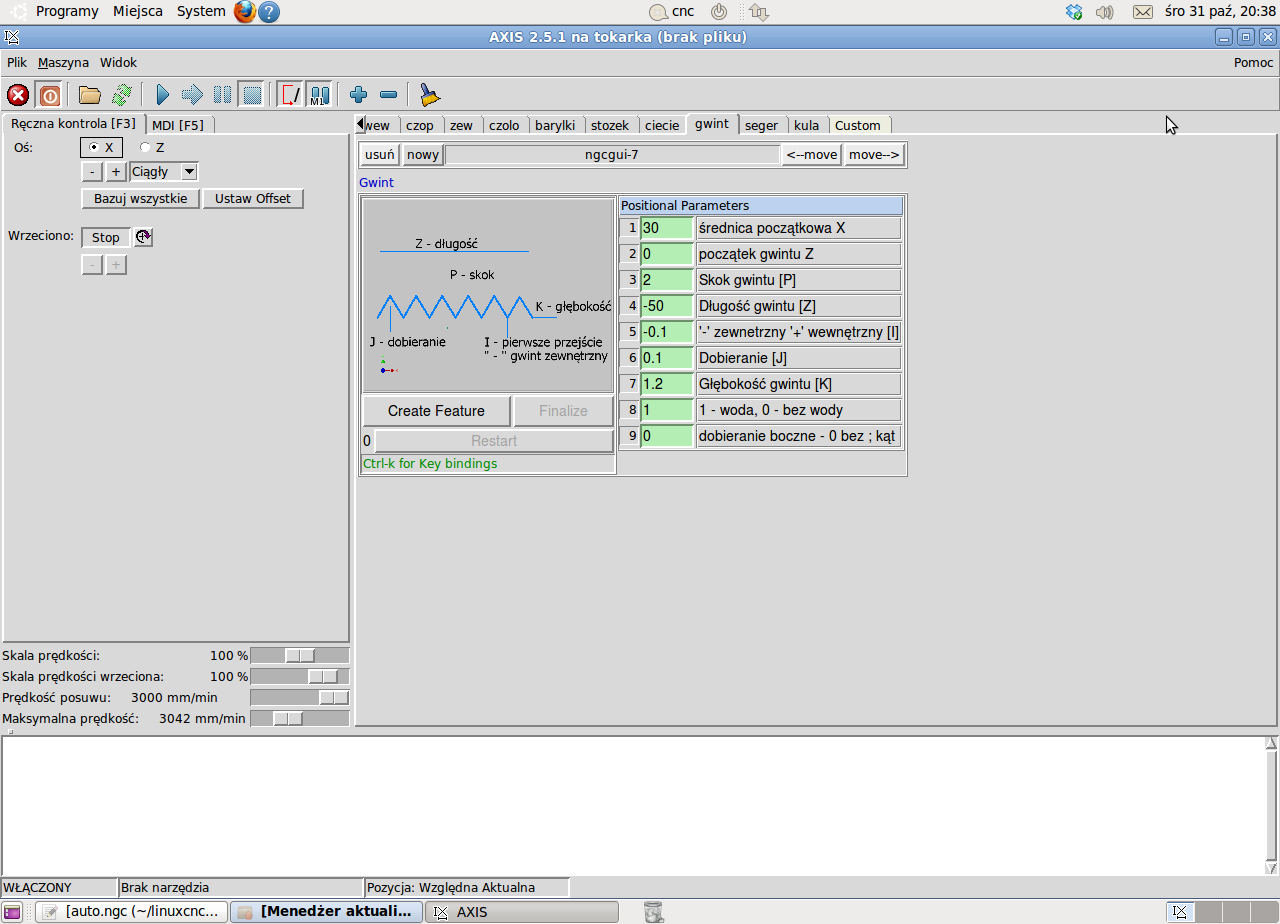

A tymczasem jeszcze problemy, bo pozmienialem plik ini, pojawily się zakladki ale tylko dwie się wyświetlają, pozostale też wyskakują ale coś w nich nie gra .
Oto mój plik ini:
[EMC]
MACHINE = TOKARKA
DEBUG = 0
[DISPLAY]
DISPLAY = axis
EDITOR = gedit
POSITION_OFFSET = RELATIVE
POSITION_FEEDBACK = ACTUAL
MAX_FEED_OVERRIDE = 1.2
INTRO_TIME = 5
PROGRAM_PREFIX = /home/hp/linuxcnc/nc_files
INCREMENTS = 5mm 1mm .5mm .1mm .05mm .01mm .005mm
LATHE = 1
# Note: TKPKG (one or more) specifies tcl/tk apps to embed in axis tab pages
TKPKG = Ngcgui 1.0
OPEN_FILE = auto.ngc
NGCGUI_FONT = Helvetica -12 normal
# for startup NGCGUI_PREAMBLE, NGCGUI_SUBFILE, NGCGUI_POSTAMBLE, TTT_PREAMBLE
# items, specifly:
# a) absolute filename (start with /)
# b) relative filename: search directories specified by
# [DISPLAY]PROGRAM_PREFIX and [RS274NGC]SUBROUTINE_PATH
NGCGUI_PREAMBLE = start.ngc
NGCGUI_SUBFILE = gwint.ngc
NGCGUI_SUBFILE = stożek.ngc
NGCGUI_SUBFILE = pólkula.ngc
NGCGUI_SUBFILE = czolo.ngc
NGCGUI_SUBFILE = czop.ngc
NGCGUI_SUBFILE = stożek wew.ngc
# specify "" for a custom tab page
NGCGUI_OPTIONS = noiframe
[FILTER]
PROGRAM_EXTENSION = .png,.gif,.jpg Greyscale Depth Image
PROGRAM_EXTENSION = .py Python Script
png = image-to-gcode
gif = image-to-gcode
jpg = image-to-gcode
py = python
[TASK]
TASK = milltask
CYCLE_TIME = 0.010
[RS274NGC]
PARAMETER_FILE = linuxcnc.var
#SUBROUTINE_PATH = /home/hp/linuxcnc/nc_files/ngcgui_lib/lathe:/home/hp/linuxcnc/nc_files/ngcgui_lib/testsuite2.5/utilitysubs
#USER_M_PATH = /home/hp/linuxcnc/nc_files/ngcgui_lib/mfiles
SUBROUTINE_PATH = ../../../nc_files/ngcgui_lib/lathe:../../../nc_files/ngcgui_lib/utilitysubs
USER_M_PATH = ../../../nc_files/ngcgui_lib/mfiles
/home/hp/Pulpit/zrzut_ekranu.png

Nie widać co wyświetla ale polskie znaki w nazwach subów to nie jest dobry pomysł :) a spacje tym bardziej :)
