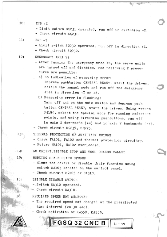

Sorry about writing english, but though I might have more success in sourcing info about this mill on a Polish forum, I have this TOS FGSQ 32 CNC B mill with a few problems, and was wondering if anyone might have any manuals/wiring diagram etc for this TOS cnc milling machine ?.
(I have the manuals for heidenhain control etc, but not for the machine itself, so that would be of interest).

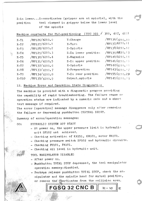

It also give me a few errors which causing the spindle not to activate
PLC: Error 44
PLC: ERROR 20
any tips in regards to these would also be of interest.

Was able to source a physical manual for it so I got to scan it in, just thought I'd post the meaning of the error messages for record
