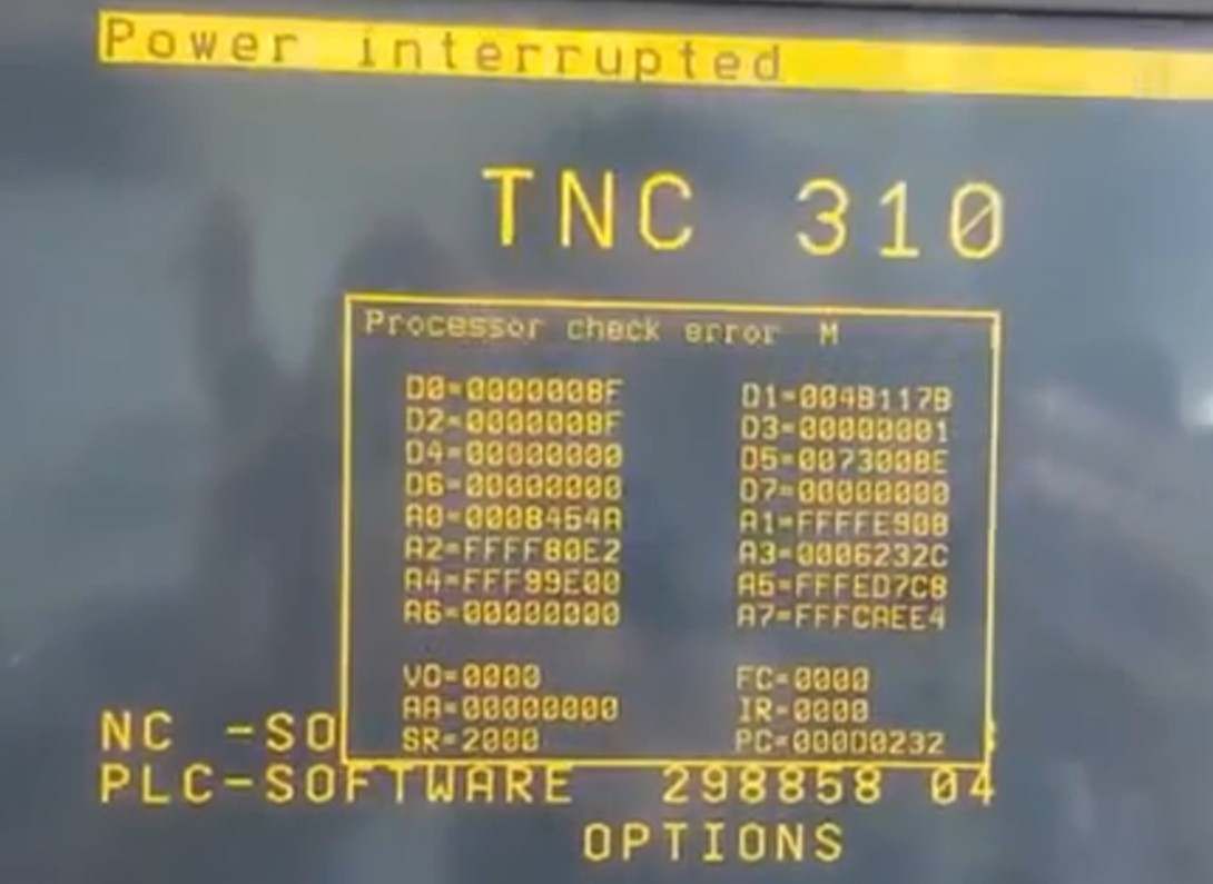

I GET THIS ERROR. DOES ANYONE KNOW WHAT THE ERROR IS?

Processor check error M Cause of error: The operating voltage lies outside the permissible tolerance.

You need to check all control voltages, especially 24VDC
