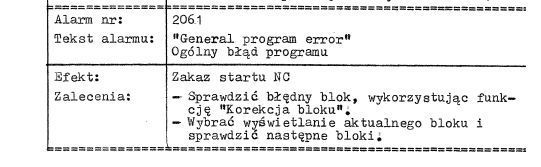

nie wiem co jest z tym cyklem, ze ciagle mi blad wywala - 2061 general program error
w symulatorze WinNC Sinumerik 810T. Z innymi cyklami nie mam problemow. Ktos wie gdzie tutaj jest haczyk?

Post napisał: ilove810T » 19 lip 2011, 18:39
ze skladnia jest ok. Znalazlem takie cos:
2061 General programming error Reset key
When executing a part program
Machining is stopped or is not started
Interlocking of NC START
The programmed distance to go has exceeded the permissible distance to go. This is dependent on the input
resolution, for example.
G63 was not programmed together with G01 (G63 has no effect with G0).
An axis for which mirroring is active has been programmed with G220 or @736.
A thread block has been programmed with thread lead 0 or distance to go 0.
G02/G03 has been programmed together with G63.
The residual path of an axis in the thread block is 0 after block search with calculation.
Check the program part and correct the incorrect setting
Check the input resolution selected
Alarm is displayed with reference to block and channel

Ruszyl cykl po skonfigurowaniu Tool Offset. Co prawda do konca jeszcze go nie robi - pewnie cos zle ustawione jest w tool offsecie, ale juz polowa sukcesu jest
