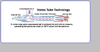

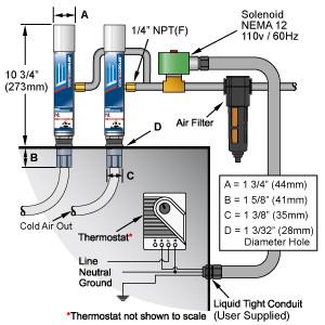

Model VOR.610 >> only: $934 <<
Adjustable Cold Air Gun
The Cold Air Gun that made others obsolete! Its precise stream of frigid air 100°F (38°C) below inlet temperature is ideal for applications where spot cooling is beneficial.
Set the Adjustable Cold Air Gun for the cold airflow rate and temperature that is optimal for the application simply by turning a knob.
Applications:
Alternative to mist coolants.
Cool machining and other heat-generating operations.
Cool plastics, metals, glass, hot melts, adhesives, solders, mold tooling and more
