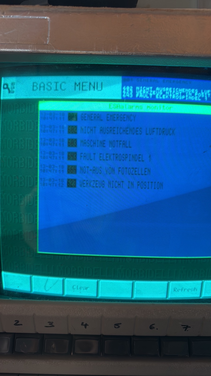

i accidentally entred the i/o config meny and said plc will block but i thinked it just go to stop and run again and after that it deleted the plc program and i/o config or also called triaset.dat i didnt have the orginal files so i got from another 504 which is the same i loaded the program triaset.dat, plc program, edit k constans and edit messages but i have two error or alarms foto zell or securit light barrier sensors and elektrospindel 1 but the problem is i have 24vdc at the input of plc but plc doesnt see the signal i dont know why because i check both machines wiring diagram both have the photo cell conected to same input my machine and the machine i have got program from it in both machine x17.3 is input for light barrier but i disaplys that as alarm also the led on input card is on evrything is fine from sensor to plc but plc doesnt sees it i dont know im very confused also same for the elektro spindel 1. can someone help me please.
thank you for evevrones time spent for reading this and trying to help me i appreciate a lot.
here is the photo of alarms
