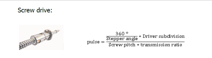

Pierwszy problem to SETUP EQUIVALET PULSE , bo nie bardzo mogę sie zorientować co oznaczają poszczególne zwroty, jakie wartości wpisać dla osi XYZ.
Posiadam śruby:
X 1605
Y 2010
Z 1605
Czy może ktoś objaśnić co oznaczają poszczególe zwroty we wzorze.?
Tekst po angielsku:
The number of pulses of the system needs to send when machine moves every 1mm.Unit:pulse/mm.
1 stepper driver:
Formula = pulses per revolution / distance per revolution Pulses per revolution formula: (360 °/stepper angle)* Driver subdivision
Some stepper drivers mark pulse number directly.
Distance/r formula:
Screw drive machine = screw pitch * mechanical transmission ratio
Rack drive machine = rack module * gear teeth number*pi* mechanical transmission ratio
So stepper motor system formula:
Formula Description: step angle is the angle of the motor parameters, motor rotation step walk.
Driver subdivison is the parameter set by the driver.
Screw pitch(above picture): The distance that the nut moves when the ball screw makes one rotation.
Transmission ratio: The speed ratio or angular velocity ratio of the capstan and the driven wheel.
Z góry dzieki za pomoc.... bo utknąlem juz na początku :)
