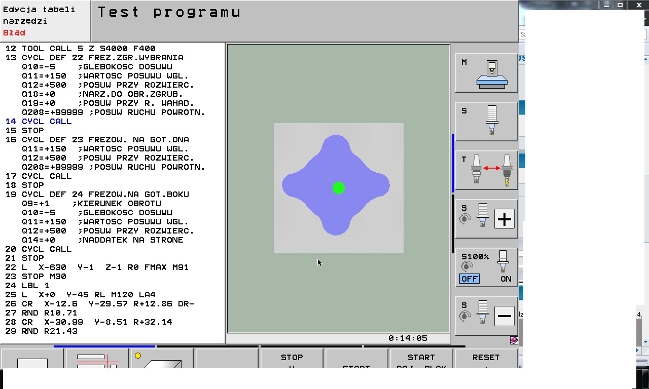

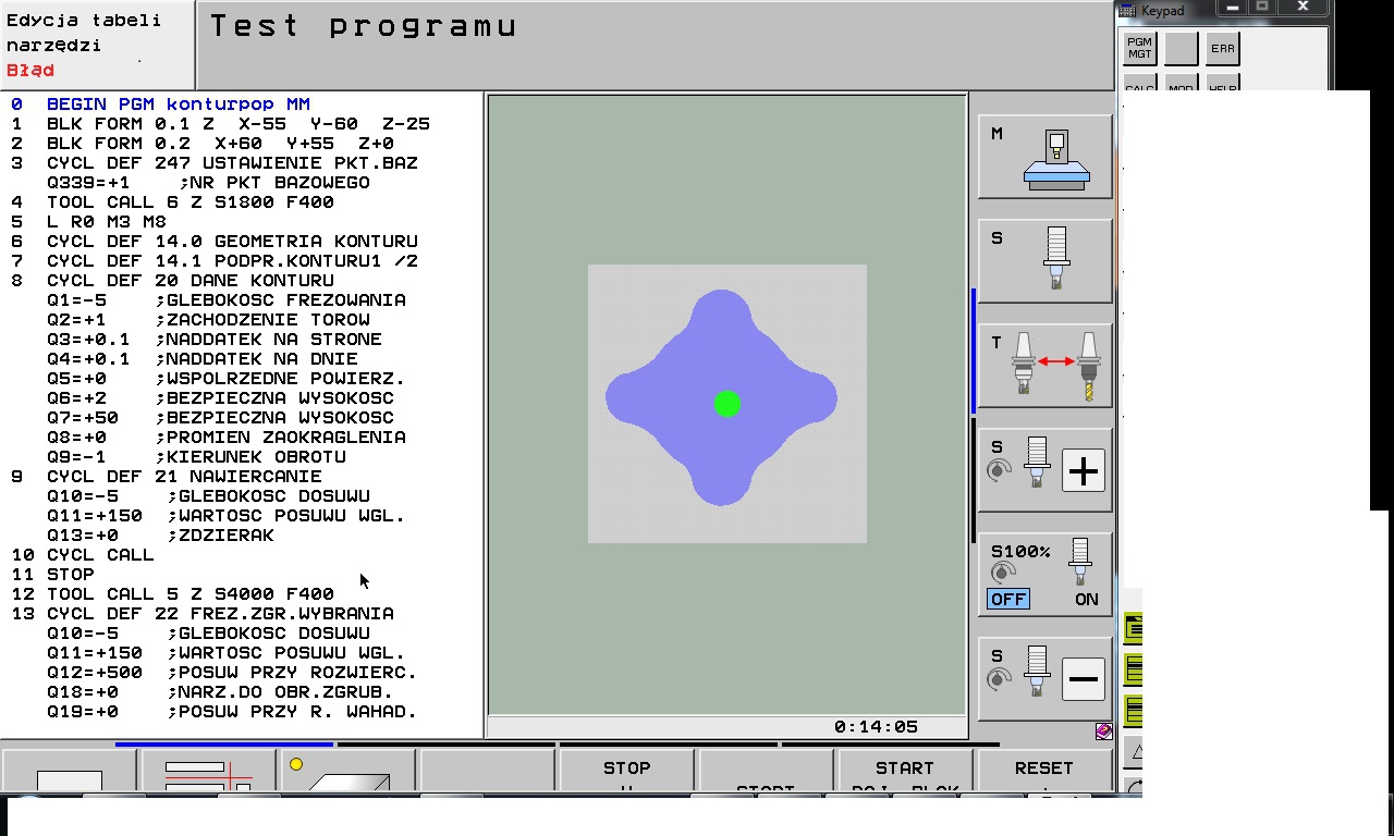

0 BEGIN PGM KONTUR MM
1 BLK FORM 0.1 Z X-55 Y-60 Z-25
2 BLK FORM 0.2 X+60 Y+55 Z+0
3 CYCL DEF 247 USTAWIENIE PKT.BAZ ~
Q339=+1 ;NR PKT BAZOWEGO
4 TOOL CALL 3 Z S1800 F400
5 L R0 M3 M8
6 CYCL DEF 14.0 GEOMETRIA KONTURU
7 CYCL DEF 14.1 PODPR.KONTURU1
8 CYCL DEF 20 DANE KONTURU ~
Q1=-5 ;GLEBOKOSC FREZOWANIA ~
Q2=+1 ;ZACHODZENIE TOROW ~
Q3=+0.1 ;NADDATEK NA STRONE ~
Q4=+0.1 ;NADDATEK NA DNIE ~
Q5=+0 ;WSPOLRZEDNE POWIERZ. ~
Q6=+2 ;BEZPIECZNA WYSOKOSC ~
Q7=+50 ;BEZPIECZNA WYSOKOSC ~
Q8=+0 ;PROMIEN ZAOKRAGLENIA ~
Q9=+1 ;KIERUNEK OBROTU
9 CYCL CALL
10 CYCL DEF 21 NAWIERCANIE ~
Q10=-5 ;GLEBOKOSC DOSUWU ~
Q11=+150 ;WARTOSC POSUWU WGL. ~
Q13=+13 ;ZDZIERAK
11 CYCL CALL
12 CYCL DEF 22 FREZ.ZGR.WYBRANIA ~
Q12=+500 ;POSUW PRZY ROZWIERC. ~
Q18=+9 ;NARZ.DO OBR.ZGRUB. ~
Q19=+0 ;POSUW PRZY R. WAHAD. ~
Q208=+99999 ;POSUW RUCHU POWROTN.
13 CYCL CALL
14 CYCL DEF 23 FREZOW. NA GOT.DNA ~
15 CYCL CALL
16 CYCL DEF 24 FREZOW.NA GOT.BOKU ~
Q9=+1 ;KIERUNEK OBROTU ~
Q14=+0 ;NADDATEK NA STRONE
17 CYCL CALL
18 L X-630 Y-1 Z-1 R0 FMAX M91
19 STOP M30
20 LBL 1
21 L RL
22 L X+0 Y-45
23 CR X-12.6 Y-29.57 R+12.86 DR-
24 RND R10.71
25 CR X-30.99 Y-8.51 R+32.14
26 RND R21.43
27 CR X-48.21 Y+0 R+10.71
28 CR X-30.99 Y+8.51 R+10.71
29 RND R21.43
30 CR X-12.6 Y+29.57 R+32.14
31 RND R10.71
32 CR X+0 Y+45 R+12.86
33 CR X+12.6 Y+29.57 R+12.86
34 RND R10.71
35 CR X+30.99 Y+8.51 R+32.14
36 RND R21.43
37 CR X+48.21 Y+0 R+10.71
38 CR X+30.99 Y-8.51 R+10.71
39 RND R21.43
40 CR X+12.6 Y-29.57 R+32.14
41 RND R10.71
42 CR X+0 Y-45 R+12.86
43 CALL LBL 0
44 END PGM KONTUR MM
