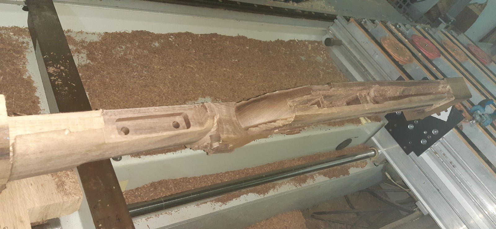

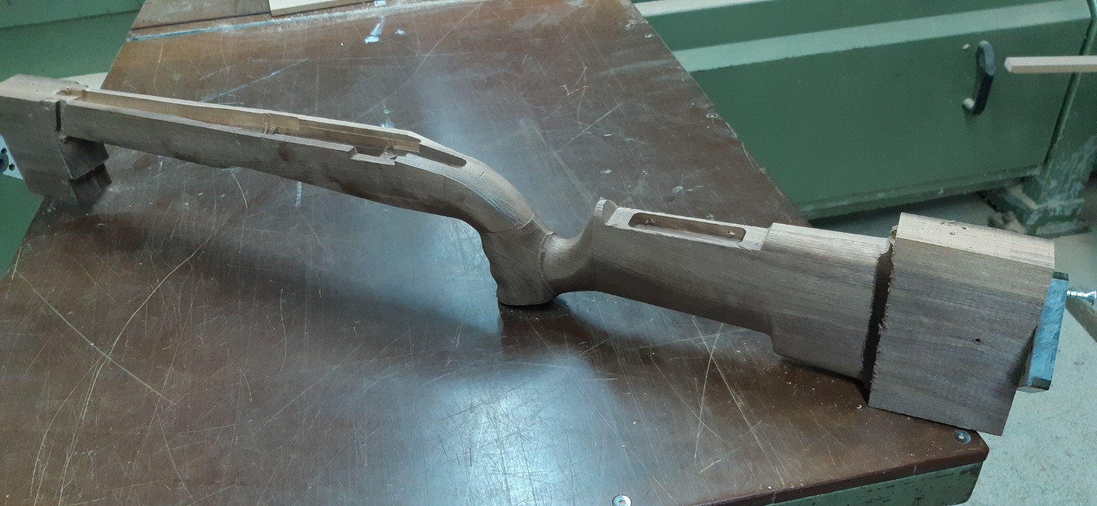

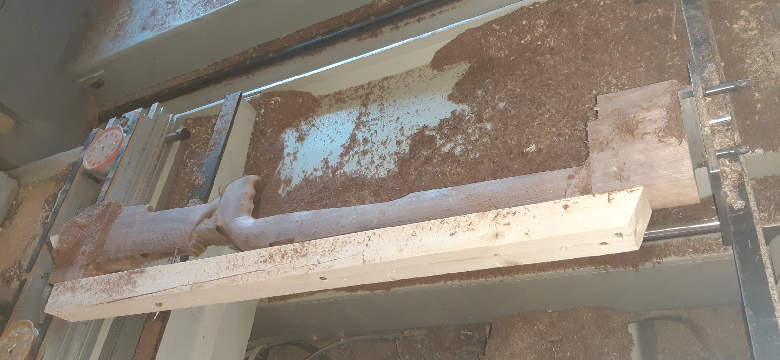

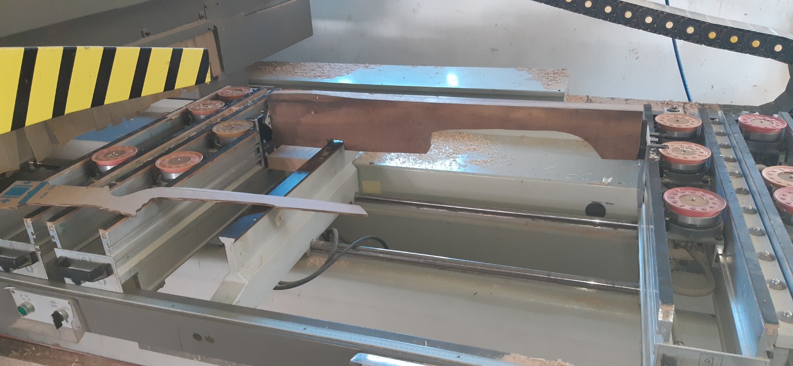

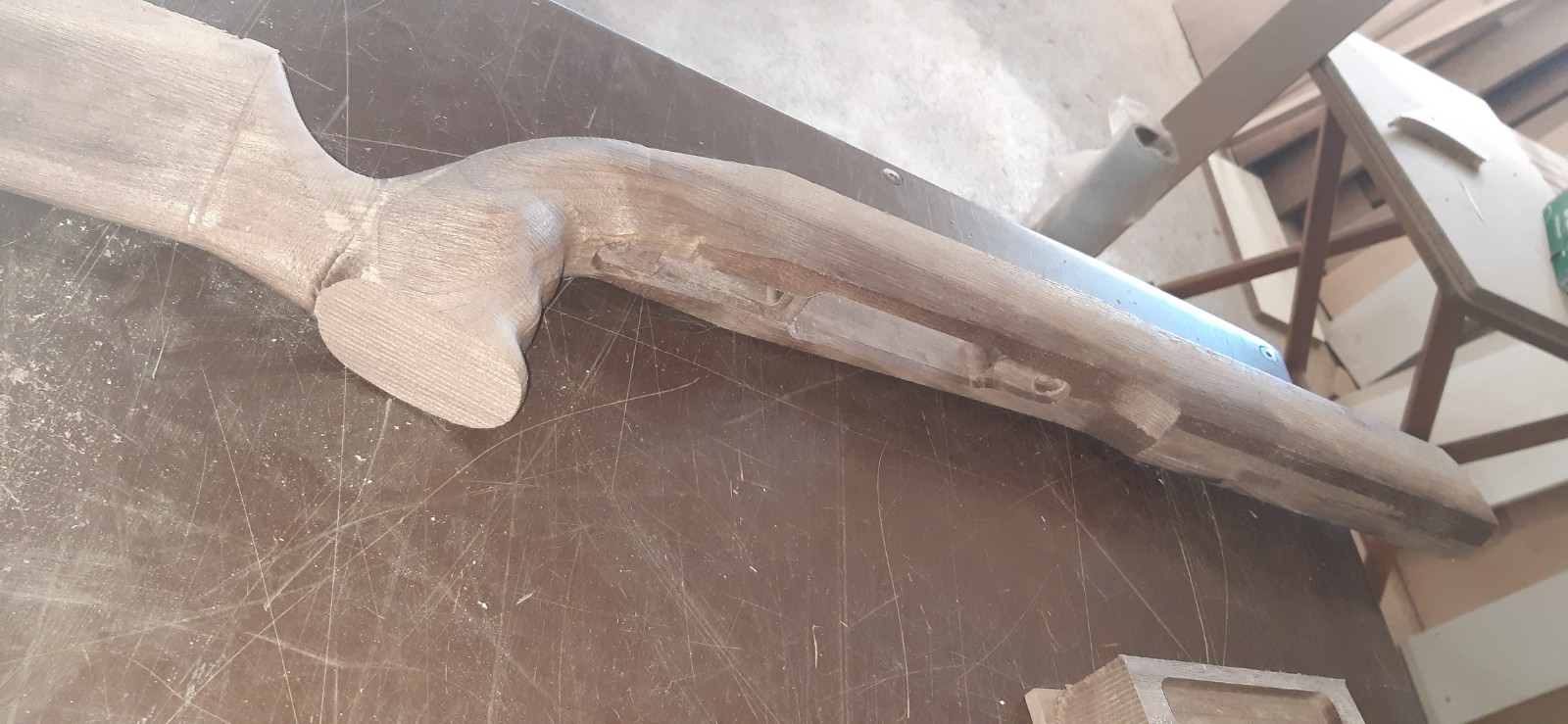

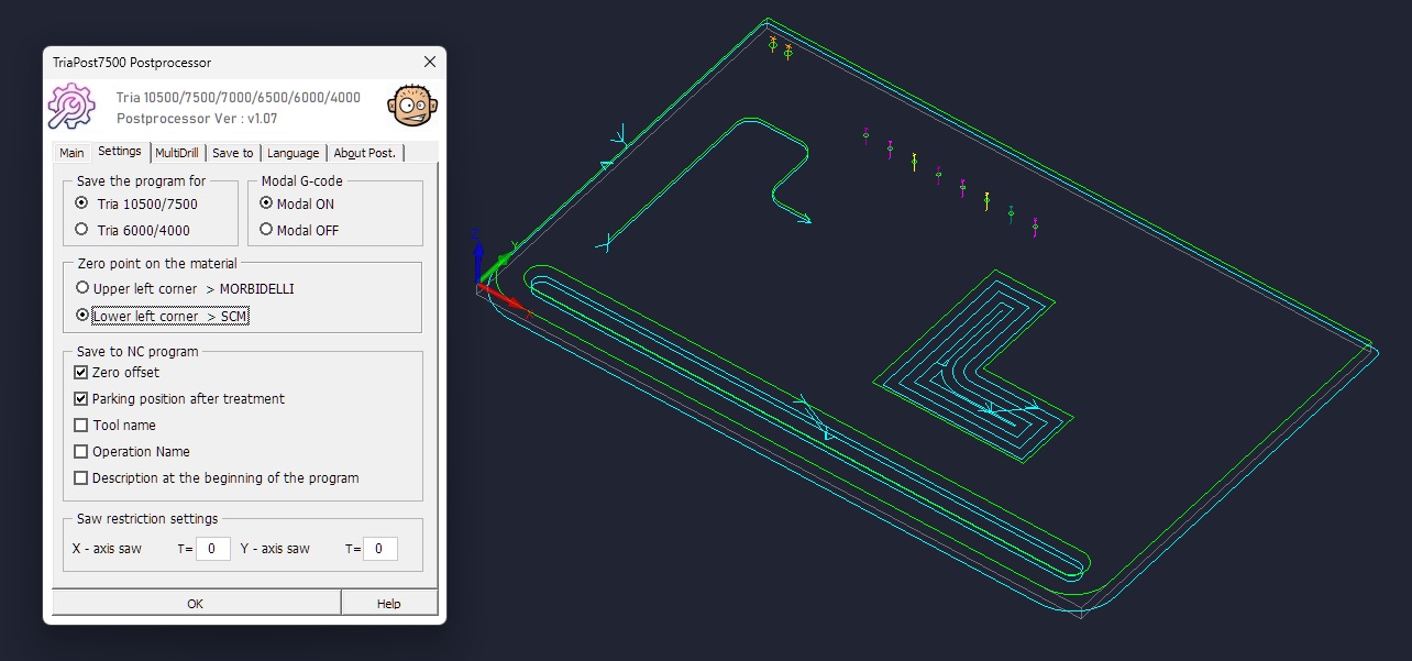

Making a Rifle Stock
With This great POSTPROCESSOR and Alphacam, i made a Rifle stock last year.
Thanks one more time to: Zbigniew Borowski , for this postprocessor.
My Friend has made his own design. It is a hunting rifle. We made a rotating center and the rifle then spins manual around this center. Then can you lock in 90°. Maybe someone will have some ideas how to start something. I use Morbidelli author 510 and the largest program that he can read is about 2000 lines. The whole stock had 36000 lines. But this is not problem. You always do just sections. Here are some pictures of working a Stock:
Obrazek Obrazek
Obrazek Obrazek Obrazek Obrazek
Maybe this solution with rotating center is not the best. Because when the stock was thiner, also was not so strong. Than i had problems in the middle. Then i had to make additional support to fix it in the middle. If i would do it one more time, i wouldnt make this "rotating center" but i would rather use like mikrojoints (minimal 20-30mm) and positioning holes where this stock could be fixed directly on a solid surface, and in the end this "mikrojoints" would be cut off manualy.
